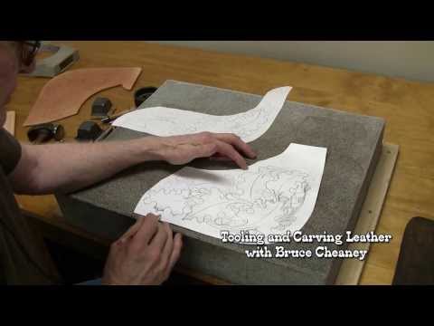

Article and Video by Bruce Cheaney You can use the building block process to learn how to tool and carve leather designs and figures ad motifs. Leather carving for beginners you can start out cutting in simple designs and learn how to control your swivel knife and in no time at all you will be on your way to tooling and carving leather. This video tutorial will show you two different swivel knives one with a five eights inch barrel and the other with a one half inch barrel. One of the … [Read more...]

I spent most of the day drawing two pencil drawings for a custom saddle that I am making the pattern is an Oak Leaf and Acorn Pattern that I have used and developed over the years.  I like to keep my patterns fresh and updated and unique to the saddle that I am making.  After I got the patterns where they suited me the next step was to trace the patterns over to the cased leather. I have a leather casing video that shows you how I case leather and you can find it here at the Leathercraft … [Read more...]
